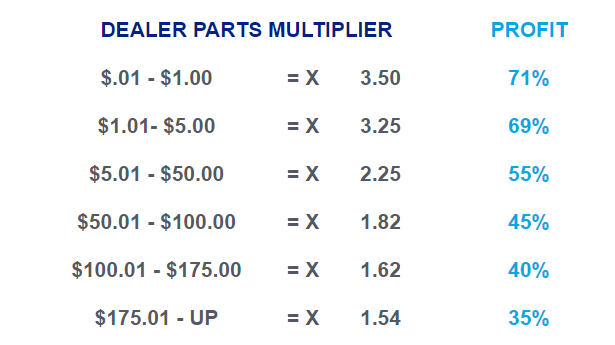

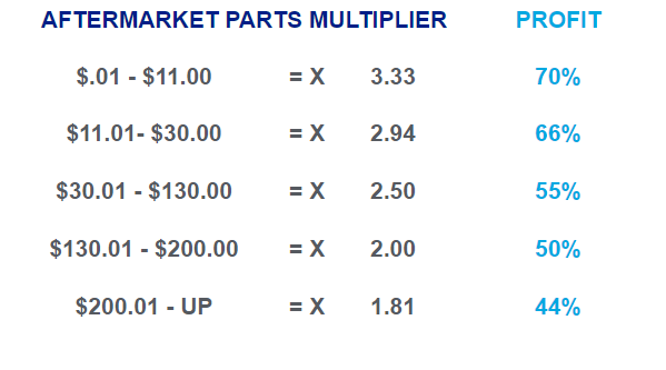

We use a Pricing Matrix in Mitchell Manager and usually carry a 56-62% profit on parts. The image below is a snapshot of our Price Markup Matrix.
