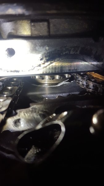

We recently took in a 2005 golf with a hole in the oil pan. It was a big hole. I made a note on the estimate that we did not know if there was engine damage because the hole was too big to fill with oil and run. When the oil pan was down we saw what looked like a pinch of bearing material squeazed out around the #1 main. We took a picture of this bearing damage then installed the pan. Added oil and car started. No power, Turbo seized. Now customer is accusing us of running the car with no oil and ruining his turbo. How would you guys handle this situation. I really don't feel like having a horrible google review calling us idiots.

I think the fact that you put it back together, and started, and ran the thing gives the customer leverage to claim liability on your part. If the rotating assembly is compromised, there will be no oil pressure, or very low oil pressure. Starting and running the engine in this condition can cause additional damage (like the turbo) to engine components that require lubrication to function. Not to mention, you could be pumping shavings, contaminants, etc all through the system. For the next go round, the INSTANT you find something you were not expecting, or something additional relevant to the outcome of the repair, you put everything down, document, and discuss with the customer immediately. Don't get caught up chasing payment for the job which many shops tend to bury themselves in. and end up costing them more in the long run.

I'm surprised you are not concerned about the spun bearing.
I would have dropped the suspicious bearing and a rod bearing to review before reassembly , I also would have let the client know may be more damage before reassembly his and or her choice , to continue.
