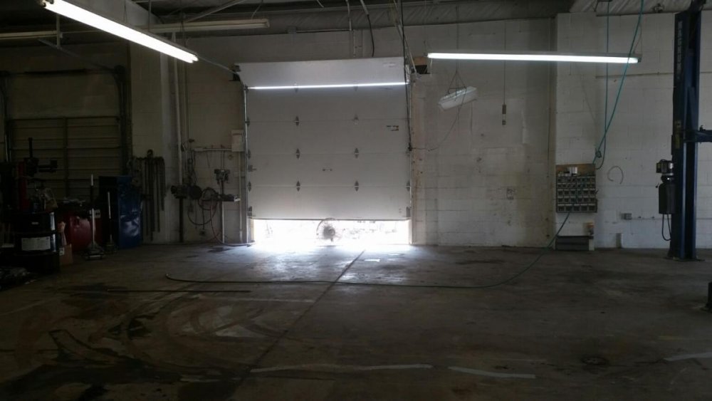

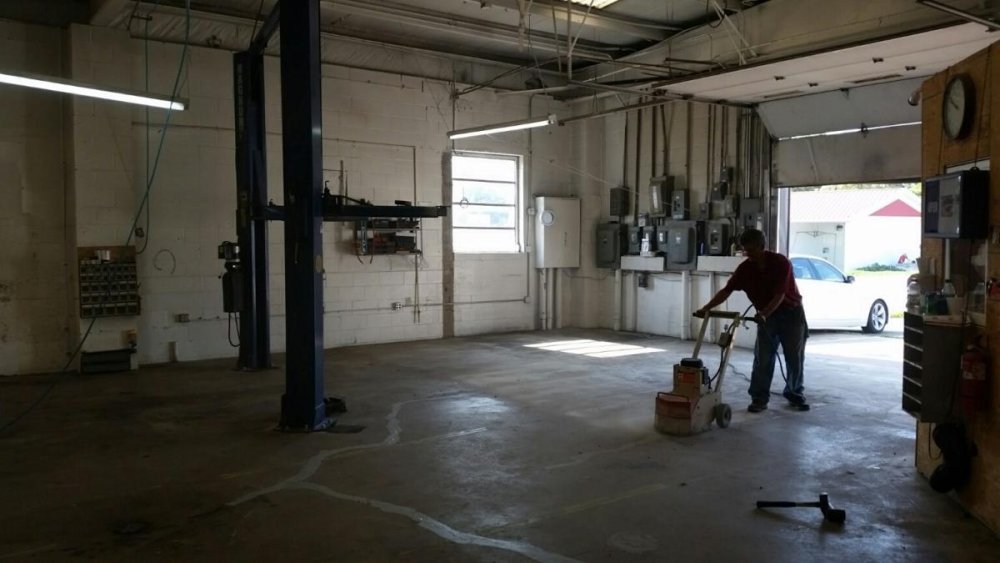

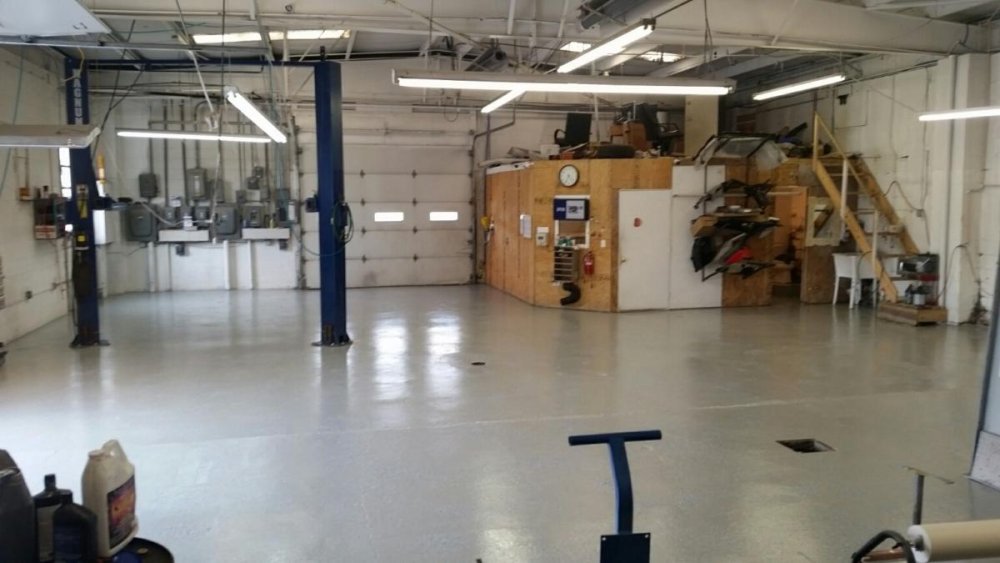

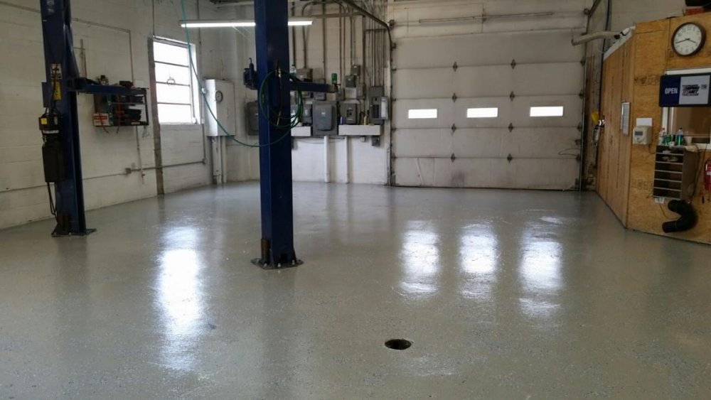

So me and my team took today off to do some repairs on the repair shop. We did not accept any appointments, took all of the equipment out including a lift, (usually sits next to the two post lift) and coated the floor with an epoxy coating.
It definitely lightens up the shop, the semi-gloss finish definitely reflects the sky lights much better. Now I'll be filtering everything that comes back into the shop to try and keep it this clean. Attached are a few pictures of the before and after. All opinions and suggestions welcome.

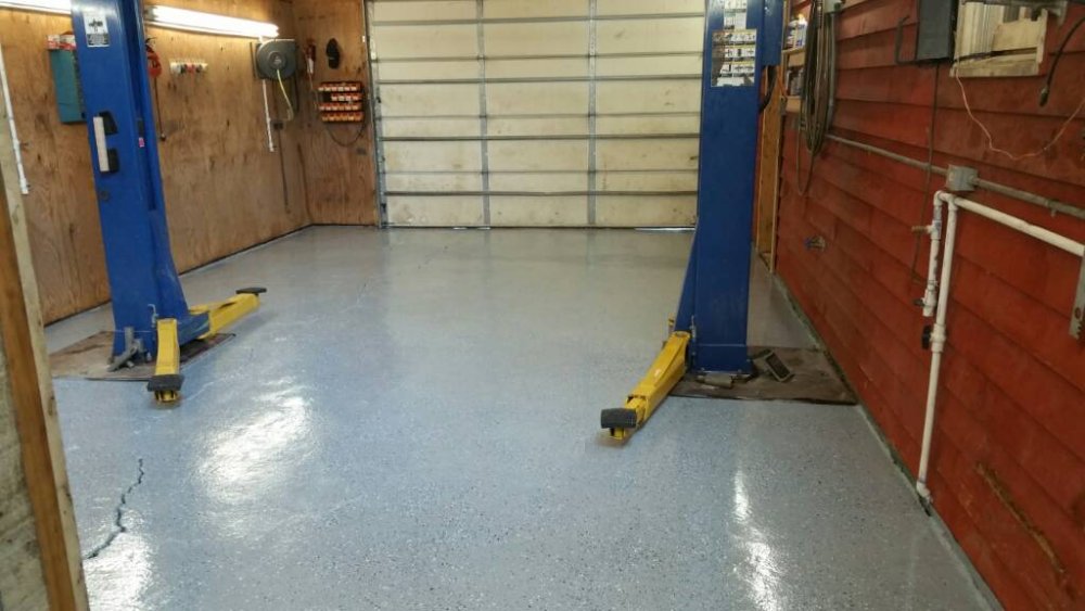

We just finished one of ours as well.
Your floor looks great! What kit did you use? Did you use a clear coat or antiskid?
Sent from my SM-N910V using Tapatalk
Thank you everyone for the kind words!
mspecperfomance, To be honest, I was surprised we got it done in one day but we started promptly at 8 and finished at 4:50 so it turned out perfect!
The floor coating I used was Rustoleum Epoxy-Shield Professional Series in silver grey semi-gloss (they also have garage series made for less vehicle traffic)
We also used their crack filler to fill any dips and cracks in the concrete, let that dry for 8 hours. Then we rented a floor sander, sanded the entire floor (mainly to remove and old stains that would affect adhesion) washed it, acid washed it, squeegeed it all out, let it dry and applied it. It was really easy to use but I guess the real test will be starting tomorrow. :)

I hope you see this before you drive on it - it will not hold up to our type of use and abuse, that's what I used. If you can make it happen go to a sherwin williams and pickup a product called rexthane, it's a clear coat that's extremely hard. You should do 1 or 2 coats. When we completed ours you could easily scrape areas that's were well prepped up. The rexthane is much harder and much more chemical resistant.
ncautoshop, Thanks so much for letting me know! That's definitely something I need to look in to. So far it's been holding up great. We'll see how it goes...
